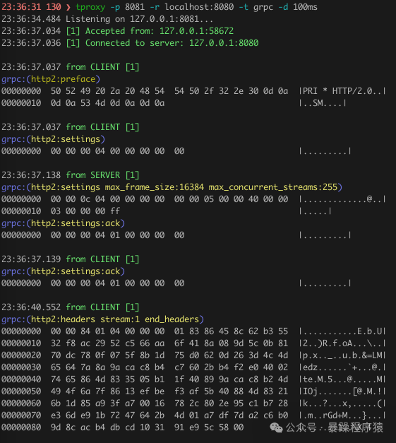

使用语法:
$ tproxy --helpUsage of tproxy:  -d duration    	the delay to relay packets  -down int    	Downward speed limit(bytes/second)  -l string    	Local address to listen on (default "localhost")  -int    	Local port to listen ondefault to pick a random port  -q	Quiet mode, only prints connection open/close and stats, default false  -r string    	Remote address (host:port) to connect  -s	Enable statistics  -t string    	The type of protocol, currently support http2, grpc, redis and mongodb  -up int    	Upward speed limit(bytes/second)
示例:分析gRPC连接。
tproxy -p 8088 -r localhost:8081 -t grpc -d 100ms
侦听在 localhost 和 8088 端口
重定向请求到 localhost:8081
识别数据包格式为 gRPC
数据包延迟100毫秒
